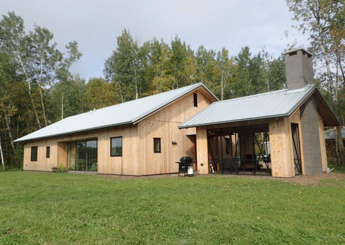

The south side of the house has plenty of glass. This photo was taken on October 4th. In June and July, all of the south glass is completely shaded by the roof overhang.
Image Credit: All images: Elden Lindamood
View Gallery 6 images
The north (entry) side of the house. It still needs stain, but, well, you know... My favorite space is the screenless porch. I’ll work on the screens next spring. The windows have drywall returns on the jambs and head. The window stools are finished with slate tile and a simple fir apron. I built a cat box box and ventilated it via the HRV exhaust duct. It controls the odors well. Our solar-powered cat recharging on the living room floor.
