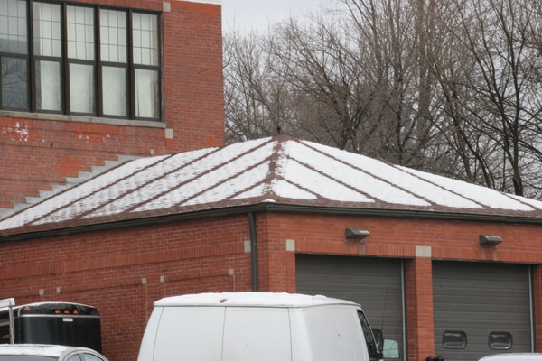

Thermal bridging in the uninsulated roof framed with steel (R-value of around .04 per inch) means bare roof at the rafter lines.

Everything is relative — especially when it comes to thermal bridging. Thermal bridging occurs wherever assembly components with low R-values relative to surrounding materials span from the inside to the outside of a building assembly. Thermal bridging takes place in wood-framed assemblies because, although wood is a pretty good insulator at about R-1 per inch, it is at least three times more thermally conductive than any cavity insulation, which start at about R-3.5 per inch.
The uninsulated roof framed with wood (R-value around 1.1 per inch) means rafter lines covered with snow.
With steel framing at about R.04 per inch, it’s thermal bridging on a whole different scale. Steel framing typically reduces the in-cavity R-value by as much as 50%, while wood framing reduces in-cavity R-value by a bit less than 10%.
Wrapping a building envelope with exterior rigid insulation cuts off the thermal bridging. Rigid insulation as exterior sheathing is a great idea for wood-framed assemblies, imperative for steel. But as in all things hygrothermal, you get a double benefit when you reduce or eliminate thermal bridging — you save energy and reduce the potential for condensation, mold, and rot.
