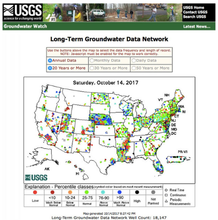

USGS Groundwater Watch
The U.S. Geologic Service has several databases related to ground water. (See the image at the top of the page.) For builders and remodelers, the most useful of these resources are probably the Active Groundwater Level Network and the Long-term Groundwater Data Network.
Each is fed by records from over 850,000 wells drilled over the last 100 years. The data are pretty thin for Vermont and probably for other sparsely populated areas, but there’s tons of data for many highly populated regions of the U.S.

    "What do I need to do to avoid basement water problems?" is an important question, but I don't think that any wide area data can provide an accurate answer. For example, my neighbor has a slow spring under his slab, requiring multiple sumps and a generator for backup power. I don't even need a sump.
