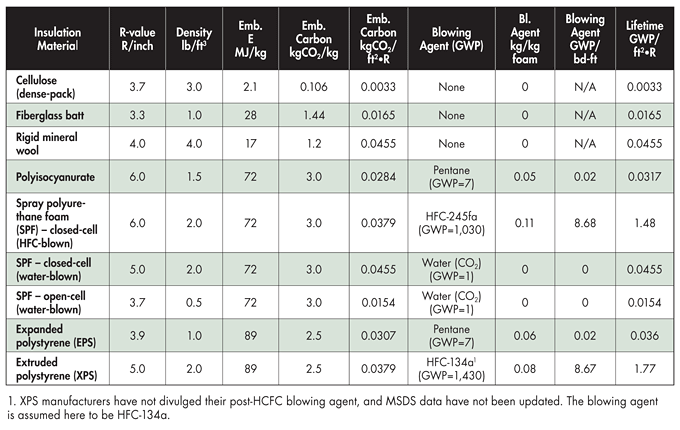

Hello Martin, I would very much appreciate seeing the data back-up for what you are claiming. I myself have never seen a "carbon footprint analysis" for a double-stud framed wall system and would love to see one. But you can not compare the opportunities for error with the field built double stud image you sent (looked like mineral wool) and a good factory made panel system. But I do agree that with COMPETENT professionals it can all end up very high performing wall system either way. The question is - again - at what cost? Short term and long term.
Allison Bailes a few years back did a fair job of debunking much of the faux science around some in the industry's claims about GWP and refrigerants in insulation - I do encourage those who wish to learn more to review it. Most notably you need to understand that closed cell foam panels do not lose refrigerant - the molecular structure is too large to pass through the cell walls - and when you are using your Igloo or Yeti coolers, or your home refrigerator - you should remember that in comfort. On the other hand you could take for example the Mitsubishi high performance mini-split using R-410a, with a GWP of somewhere around 1,700 to over 2,000, depending on which chart you use. The AC system itself will use more blowing agent with a greater GWP impact than the foam in our wall panels.
I will try to attach some substantive data charts from an older BuildingInsight presentation - I believe commissioned by BASF - that used the TUV (German) method of Ecoefficiency Analysis to compare materials, methods and outcomes. Remember you can't just look at a single material - like trying to compare cellulose and PUR closed cell - you have to look at the overall picture and the pros & cons of each system. And the foam they selected in the charts I am attaching had a much higher GWP than the one we are using today and it still beat the single stud stick frame methods. But I would love to see the numbers for a double stud system.
As a scientist I prefer it when people actually use data to back up their claims, but I understand many in the construction industry are not used to that. We are working very hard to educate and we welcome all informed conversations. I do wish all of you the best in your endeavors, which ever way you choose to build.
Charles,
The graphs you posted emphasize the importance of lifetime utility costs. These are significant for most buildings, of course-- no argument there. If you are comparing a cellulose-insulated building to a SIP-insulated building, it's only fair to compare identical size buildings with identical air leakage rates and identical annual energy bills. Needless to say, it's possible to build a 2,000 s.f. building with R-40 walls, R-40 ceilings, an air leakage rate of 1 ach50, and an annual energy bill of $1,000 using either cellulose insulation or polyurethane-insulated SIPs.
So, item 1: Compare apples to apples. The energy bills will be the same, so they are irrelevant to the discussion.
Here is a link to an article that discusses the embodied energy of insulation materials: "All About Embodied Energy."
In that article, I wrote:
"There are several online sources of information on the embodied energy of insulation materials. Environmental Building News lists the following embodied energy values for R-20 insulation covering one square foot:
"While Environmental Building News reports that the embodied energy of EPS is somewhat higher than that of polyiso, information compiled by Mike Eliason for his Brute Force Collaborative blog shows that the embodied energy of EPS is somewhat lower than that of polyiso. Let’s call it a tie. Eliason reports that the embodied energy of XPS is higher than either EPS or polyiso.
"One source reports that the embodied energy of spray foam insulation is about the same as that of EPS.
"Every source reports that the insulation material with the lowest embodied energy is cellulose."
A fallacy in the caption of that middle slide is the assertion that "GWP is primarily a result of energy for heating and cooling the home over a lifetime."
That depends entirely on the assumptions. A heat-pump heated/cooled house with 100% renewable power inputs has but a tiny fraction of the lifecycle GWP of the same house with 100% fossil fuel inputs. At the rate of the greening-up of the grid, the error bars on greenhouse emissions over the lifecycle of a house can't be assumed even with the heat pump/dirty grid example.
Cellulose insulation is sequestered carbon, for at least the lifecycle of the house, and usually beyond. If one calculates the emissions of the processing energy from paper to finished insulation product it's comparable to fiberglass or rock wool, but lower than any polymer system (even half pound polyurethane.) When discounting those initial energy input emissions due to the fact that it's recycled material from other uses it tips VERY favorably toward cellulose:
It's true that R410A has large GWP, but the volumes used for small load systems are actually pretty small compared to the amount of blowing agent it takes to do a high-R house with closed cell polyurethane, and small compared to the emissions of heating with fossil fuels. Over the lifecycle of a house it's likely that R410A will give way to R744 (CO2) or an HFO1234__ variants for heat pump applications, and most equipment vendors are actively researching those options right now. (HFO1234yf is has been the standard automotive AC refrigerant in Europe since 2011, though there are a few Daimler/Volkswagen models that have used R744 such as the VW Phaeton, Mercedes E & S Classes, and Audi A8. )
The presumption that all R410A ever gets manufactured will end up in the atmosphere isn't particularly well founded either- it is regularly recaptured during equipment repair/replacement. But it's hard to see how foam blowing agents can be similarly managed at end of service life. Hopefully some of the HFO1234 solutions used in site-applied closed cell polyurethane can be made to work in SIPs too.
Despite the straw-man BASF slides (that presume heating energy is only from natural gas, and a much lower R for fiber insulated houses than the polyurethane insulated house) presented by Charles Leahy in response #28, BASF is now using HFO blowing agents in their Elastospray® LWP closed cell foam products, launched about a year ago:
But polymer-per-R matters, since the polymer has it's own still-relevant GWP footprint. (That's why in response #19 I asked, "The polymer weight per R-foot is...??" ) It's not clear from the information available on the Eco-Panels website what the density of the polyurethane, is only that it's about R7/inch. It could be 2lbs per cubic foot or 4 lbs, or something in-between, but probably not less than 2lbs.
Even the polymer content of 2lb closed cell polyurethane has a lifecycle global warming footprint per R nearly 10x that of cellulose (when the paper manufacturing inputs are discounted for being recycled material on the cellulose), which is comparable to Type-I EPS. (Half pound polyurethane is quite a bit greener per R than EPS.) That's still quite a lot better than the ~400-500x multiplier when 2lb polyurethane is blown with HFC365mfc or HFC245fa.
Even if the trees were felled and processed solely for purposes of making cellulose insulation, the polymer in 2lb polyurethane blown with HFOs would still have ~2x the lifecycle GWP per R of the cellulose. But that's 2 times a fairly small number, and comparable to some other insulation products.
I look forward to the day any polyurethane SIP manufacturer comes up with a low-GWP solution, which would be in the same order of magnitude lifecycle GWP as EPS core SIPs, but with several favorable characteristics.
Charles,
Cellulose: 600 BTU
Mineral wool: 2,980 BTU
Fiberglass: 4,550 BTU
Polyisocyanurate: 14,300 BTU
EPS: 18,000 BTU
https://www.buildinggreen.com/sites/default/files/live/images/embodied_GWP_with_title.gif
