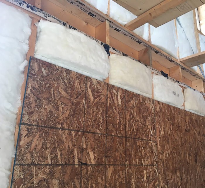

Compressing fiberglass batts behind an OSB air barrier lowers their nominal R-value but it still proves to be a good choice
The OSB air barrier on the inside of the wall compresses the fiberglass batt insulation slightly. Despite warnings, the process worked just fine.

My plans called for fiberglass batt insulation in the stud cavities with an OSB air barrier to the inside of the wall and EPS foam sheathing on the outside of the house. The problem is that the walls are framed with 2x8s, and my check of local suppliers found there are very few fiberglass options for a 2×8 wall (7 1/4 inches deep).
Several companies make batt insulation in thicknesses of 8 1/2 inches (R-28) and 7 1/2 inches (R-22). Another option was to gang up batts of different thicknesses and R-values but this seemed complicated and installation could take twice as long. In either case, the insulation will have to be compressed into the wall cavity with the OSB. Yet another option was blown in fiberglass. At about R-29.8 it is the best option for conformity inside the wall cavity and provides the highest R-value. This would be my best option if budget allowed for it.
Before making a final choice about which products to use, I decided to further investigate the documented effects of compressing fiberglass insulation. I have heard people say you shouldn’t compress fiberglass insulation. However, this depends heavily on installation details.
So, can you compress a deep fiberglass batt into a shallow stud wall cavity? You sure can, and even though compressing the batt lowers its nominal R-value, you still end up with a higher R-value than a standard batt would provide. The formulas are pretty simple.

My work-around was to use the whole batt in the cavity without cutting it to width. At 1 1/2 inches larger than the cavity in places, the batt would only be wider than the RESNET specification by 1/2 inch. The effect of this is compression along the width of the cavity. Since the R-Value changes linearly with compression, I would expect the same formula above applies to the width of the cavity also. So, using the above formula and my calculated R-value under compression (i.e. R-27.7) the insulation would have a variability from R-27.1 to R-26.8, assuming a perfect installation.
Fears of bulging walls were unfounded
Several people suggested that this much compression would lead to issues with installation of the interior OSB air barrier — bulges in the OSB between the studs. We mocked up a batt installation and covered it with a sheet of OSB. We did need two people to install the mock up: one person to hold and compress the insulation with the sheet of OSB, and the other person to nail the OSB in place.
The trick was to start nailing at the bottom plate (a pneumatic nailer worked best). We then pushed the sheet in (compressing the insulation behind it) about 16 inches up the wall and nailed it again. We kept doing this until the full sheet was nailed. After installation was complete we ran a straightedge horizontally across the OSB and found no bulging from the insulation. The bending stress on the OSB across a 2-foot span appears nonexistent. Compressing fiberglass with OSB works fine. However I can guarantee that anything more than R-31 is very hard to compress. Don’t bother trying it!
Installation of the batts was tricky at first. Simply pushing them into the cavity led to uneven filling. Repeatedly, the batts did not fill the corners of the wall cavity at the exterior side. To correct this we had to start by angling the batt into the corner while compressing it in width to fit into the opposite side. We would use our hands to pull the insulation away slightly and visually inspect the corners and tucked the insulation into the corners as needed. (See Image #2 below.)
The trick to making it puffy is to make sure the batt is tight-fitting but only about 1/2 inch bigger than the stud cavity in both height and width. The batt then slips in the cavity with ease and the center still bulges outside the stud cavity which will make for more uniform compression once the OSB is installed.
Having several people to install insulation makes the job move along quickly. However, it also introduces some variations in results. We inspected each other’s installations and watched one another’s installation method to narrow down the best way to achieve a good installation and came up with a set of rules. Our reasoning was that approach would yield a more consistent result.

After completing the insulation, we started installing the first component of our airtight barrier, the OSB. We just followed the procedure we had mapped out with our mock-up. Since we wanted to keep joints to a minimum, we worked with full sheets.
