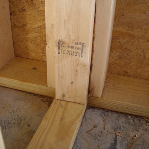

Ladder T-walls
This one is a no-brainer. When an interior wall intersects an exterior wall, the standard practice is to use three studs to complete the T-wall. The photo above shows what that looks like.
[Image credit: U.S. Department of Energy]
The oriented strand board (OSB) sheathing you see in the photo above will get covered with insulation. The space between those two studs in the exterior wall, however, won’t get any insulation. There’s no way to get it there. (Well, you could drill holes and try to spray foam in there, but spraying foam in a closed cavity risks blowing out the wall or leaving voids. Plus, few builders would take the time to do that.)
One easy solution is the ladder T-wall. The diagram at right shows what it looks like.
Rather than vertical studs, you take some of your scrap wood and run it across horizontally. You put the wide side against the T-wall stud so you have space in the back to insulate that cavity. It’s beautiful! You save wood and get a better-insulated house, too.
The photo above is from the North Central Georgia affiliate of Habitat for Humanity. We work with them and are always impressed with their ability to implement stuff like this.
Here’s what it looks like in real life (right).
It’s got 1-by deadwood for drywall and what is essentially fireblocking through the cavity.

  1. User avater
    Robert Opaluch | | #1
    Further detail please
    Could you give more detail, or a diagram, to clarify the photo describing
    "1-by deadwood for drywall and what is essentially fireblocking through the cavity"?
    Thx.
  2. User avater GBA Editor
    Response to Robert Opaluch
    Robert,
    Like you, I'm not familiar with Allison's terms. Must be Georgia jargon.
    The 2x4s that are "essentially fireblocking" are horizontal 2x4 nailers, installed stud to stud.
    What Allison calls "1-by deadwood" is what I would call a vertical nailer, installed to catch the drywall in the corner.
  3. User avater GBA Editor
    Allison A. Bailes III, PhD | | #3
    Robert, sorry about the confusion there. Martin's answer is correct. The 4th photo in the article shows an example of what I was trying to describe. The deadwood is, I believe, a 1x4, nailed to the interior wall in the T and to which the drywall is nailed.
    The fireblocking is like the ladder part that I described in the ladder T-wall except that the 2x4 is nailed with the long dimension running horizontally instead of vertically. That prevents the compression you get with fiberglass behind the ladder "steps" but increases thermal bridging.
    Does that make more sense?
