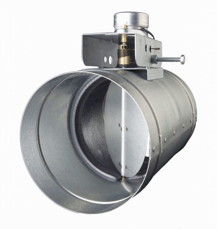

Supply-only system problems
When I test out and inspect a home for certification, checking for an operating ventilation system is a piece of the action. For an Energy Star home, the ventilation system’s flow rate must be tested. Other programs only require that the system be installed and sized properly, without any other field verification.
Most supply-only systems I run into include a motorized damper connected to a control with a ventilation cycle function. I have yet to see an HVAC installer who figures out the CFM coming in through the supply duct, calculates the required ventilation rate, and sets the fan control to meet ASHRAE 62.2. They just put in the damper and controller and assume everything will work out fine.
In several cases, I have seen the dampers installed so that they default to the open position – sometimes causing duct systems to fail leakage tests, particularly if they don’t have a good outside damper. In these cases, no one has any idea if the ventilation system actually does what it is supposed to do.
