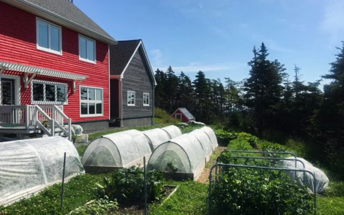

The Newfoundland project is complete: David Goodyear has finished work on his house and greenhouse in Newfoundland, Canada, and is enjoying the fruits of his labor — lower energy bills and a continuing supply of healthy food. His first post was published at Green Building Advisor on May 31, 2017. Photos courtesy of David Goodyear.

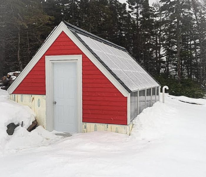

Completing the greenhouse
Unfortunately for readers, I don’t have many pictures to share that illustrate details for air sealing and insulating, or how I designed the air barrier, or how I vented the rainscreen and roof. But I do have results!
Growing in an insulated subterranean environment does work. But it only works well if you choose the right crops. When designing the greenhouse I opted for minimizing the number of holes in the envelope and I made it pretty airtight. I haven’t done any blower door tests, but you can feel the pressure differential in your ears when closing the door, and sometimes the door springs open if it doesn’t latch immediately.
Choosing the right crops was key to a bountiful harvest.
Early in the fall (September), the greenhouse was hot. That’s not surprising given the high level of insulation and large amount of glazing. I did run a fan to help keep the building cool and the GAHT system (what I call a climate battery described in this post) was almost always running on sunny days. Luckily, we don’t have many sunny days. That being said, it was manageable, but growing in the middle of summer may turn out to be tricky. The University of Minnesota Deep Winter Greenhouse producers guide recommends closing the structure up for the summer and letting it bake. The inside temperature can get high enough to kill any soil borne diseases and rid the structure of any pests. I may decide to do this when the summer comes.

February is cold and can hit -15°C.  However, the days are longer and typically there is more sunshine than in December and January. So I am expecting that production will pick up again soon.
As of January 6, the greenhouse is still above 0°C with no active heating despite 8 1/2-hour days. So far we have been able to a meet 10°C differential with respect to the outside overnight. For example, today it is -6°C outside (complete cloud cover) and the greenhouse is at 4.2°C. As of now, neither the GAHT or the 4 kW heater has been activated by low interior temperatures. This is pretty amazing.
