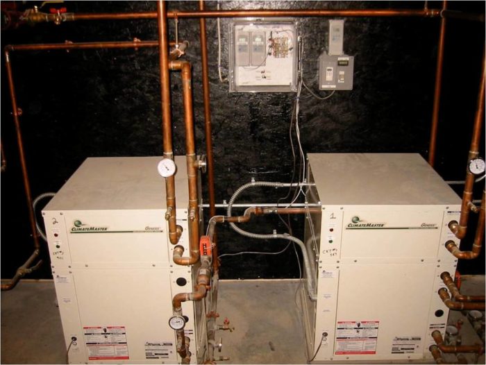

A pair of ground-source heat pumps

In Part Two of the podcast, we discuss:
  • A tale of two houses: Chris shares a story of two houses—one a success, and one that had to abandon using a ground-source heat pump
  • Rule of thumb for flow: 3 gal. per minute per ton of heating/cooling
  • Rules of thumb for well depth: Open Loop
55-ft. depth per ton at 30% bleed
85-ft. depth per ton at 10% bleed
150-ft. depth per ton at 5% bleed or less
  • Rule of thumb for well depth: Closed Loop
175-ft. depth per ton

Chris: It’s OK that it creeps you out, because there are some ramifications to this. Here’s a rule of thumb: If you’re doing an open loop system and you’re allowed to have 30% bleed, then it’s basically 55 ft. per ton of cooling. If the demand of the house is lower than the well is shallow…if you’ve got a high-demand house, then you need more water, you need more mass and you need more flow.
Phil: And it’s more expensive. So, smaller, more efficient house, and everything else gets cheaper.
Chris: If you can get down to 10% bleed, then you’re 85 ft. per ton. This is a standard 8- or 6-in. well casing. If you’re at zero bleed, then you’re at 150 ft. per ton. So, if you need 5 tons of heat, then you’re in a really deep well. And if you have an even higher-demand house with zero bleed, then you’re digging even deeper.
Now, back to that example of the house that didn’t work out—we were getting low yield off the well. We were probably getting 2 gallons a minute, and we had dug down 250 ft. That means we would have had to dig down quite a bit deeper, and in this region, we probably would have hit salt. If we hit salt water, everything has to be stainless steel, and it gets crazy. And we’re not allowed much bleed. So, we’d need one well to dump our bleed in, and we’d need two wells to feed the house. We’d be digging three wells for this house to make a geothermal system work. That’s insane.

Chris: In a closed loop system, you can do horizontal or you can do vertical. If you’re doing horizontal, that means coils of PEX tubing. You’ll dig down 6 to 8 ft. deep.
Phil: Oh, is it that much?
Chris: Well, if you’re in Virgina, 4 or 5 ft. deep. If you’re in Maine, 8 or 10 ft. deep—which is why we don’t do it here. There are only a few installations, and they’re not doing well. The closed loop horizontal is not so good when your frost depth is 48 in. That means the temperature is 32. Here in Maine we go vertical rather than horizontal.
Phil: So, unless you own a backhoe—which most of us do up here in Maine…
Chris: In a vertical closed loop system, instead of burying the tubes, you’re shoving them down a well—so the well has to be quite a bit bigger, because you’re not using the well water; you’re using water that you put into the well and draw back out again. That would typically be 175 ft. deep per ton. It’s not unheard of to be 1,000 ft. deep to do a closed loop vertical system.
Phil: I thought you were talking me into this.
Chris: No! Because a closed loop system—while more stable and more controlled and not dealing with bleed issues; you already know how deep you’re going to go and you’re not concerned about the flow of the well—that’s a lot of infrastructure.
