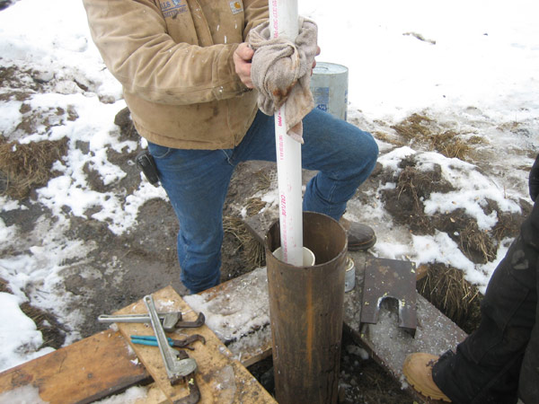

A concentric well is installed for a closed-loop system.

3. What’s your preferred way of doing a ground-source heat pump system (e.g., open loop with radiant slab distribution)?
Jim: Closed-loop concentric high-producing well with water to air using ECM technology circulating pumps and fans for most homes, providing heating and air-conditioning with radiant in the baths and kitchen.
Jeff: Our preferred way of doing a ground-source heat pump system is open loop, using either a ducted or radiant heat distribution system.
