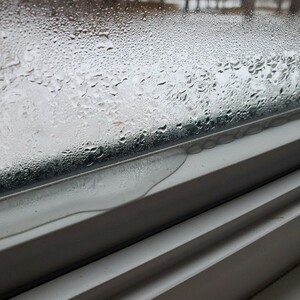

Prior to finding a solution, the windows of this newly built 900-sq.-ft. house in Oregon were sweating so much it threatened to rot the interior wood frames.
High wintertime interior humidity issues are rarely discussed with respect to today’s “tightly” constructed homes. Most Internet search results concerning this topic return articles about the “ideal” humidity level for household interiors in winter. I’d like to offer some insight I acquired from practical experience with hope that these details can help others from having to prematurely remodel their new homes. The application of information learned during the design phase can definitely help avoid problems down the line.
Conditions and construction
This story begins in 2018 with the research and design of a small, energy-efficient house in the City of Ashland, Oregon, which is just north of the California border along Interstate 5. Ashland’s climate can be described as a mix between Western Oregon’s marine temperate and California’s Mediterranean, with an occasional twist of alpine harshness. Although the average temperatures are temperate, the record lows and highs for each month indicate that such temperature extremes do occur. The ASHRAE annual dry bulb temperatures are 18° F (-7.7° C) low and 104° F (40.1 °C) high.
During the first winter occupying the house we noticed condensation forming on the bottoms of most windows, especially in the mornings. Condensation build-up was beginning to ruin the brand-new Douglas fir window frames, and so began our humidity investigation and remodeling odyssey.

The window package consists of double-pane, low-E glass with a U-factor of .27. The interior window frame material is Douglas fir and the exteriors are fiberglass. For fresh air, our house design includes the Lunos e² fan system for heat recovery ventilation (HRV). This is a simple, highly-efficient ductless system. It operates with two fans installed directly in the exterior wall. The regenerative ceramic core is charged every 60 seconds, after which the fan reverses and the incoming air absorbs the stored heat on its way in.
After learning that our windows were not faulty, one of my first questions was: Where is this excess humidity coming from?
I came up with a list of possible sources:

Maybe the issue is related to the house being small, or the fact that the interior frames are wood, or that we used double-pane glass, or that the Zip System sheathing has a permeability to the outside of 12 – 16 perms. These factors make for a very tight and energy-efficient building envelope/air barrier, which of course can’t be changed.
Solutions pointed toward reducing and removing the excess humidity as efficiently as possible. We purchased a hygrometer to measure interior humidity but found that even when we eliminated the leading moisture culprit, air-drying our laundry, the condensation issues persisted.
Ecor Pro Dehumidifer
Ecor Pro 50 desiccant-wheel dehumidifier installed upside down on the ceiling of the pantry.  Note the 1-1/2-in. moisture vapor duct pipe running from the dehumidifier unit through to the outside of the house. These units can be mounted upside down since they do not produce liquid water.
We concluded that installing a desiccant-wheel dehumidifier would be the best answer to our condensation woes. These relatively small units create water vapor as opposed to liquid water output. They work by installing a 1-1/2-in. moisture vapor duct pipe from the dehumidifier unit to the outside. It is true that dehumidification takes energy, but the amount is small compared to running a clothes dryer, which is essentially a quick, high-powered dehumidifier when properly vented outside.

Many parts of the U.S. have winter nighttime temperatures below 30 degrees. This seems to be the threshold when condensation begins to form with interior humidity in the 40% range. This level of relative humidity is difficult to maintain in a tightly constructed house. Without dehumidification, our small, energy-efficient design couldn’t dissipate the moisture we were creating.
Aprilaire humidistat
High-capacity dehumidifiers are often controlled with remote-mounted humidistats that keep track of humidity levels and run the dehumidifier as needed to keep the indoor air at the specified relative humidity. Photo of courtesy of Aprilaire.
Another note of importance is dehumidification control, which can be accomplished with a wall-mounted device called a humidistat. By incorporating an outdoor sensor to measure the exterior temperature and adjusting the control for every 0.5°F fluctuation, a smart humidistat can increase the setpoint during warmer weather to achieve greater comfort and decrease the setpoint during colder weather to avoid window condensation. Controlling interior humidity—depending on exterior temperature—saves energy since outdoor temperatures usually rise during the day, when not as much dehumidification is needed.
In short, the colder it gets outside, the lower the interior relative humidity percentage needs to be to alleviate condensation, as evidenced in Table 1:
Outdoor Temperature/Indoor Relative Humidity table
Installing a small dehumidifier has alleviated our winter window condensation problems. If your project involves designing with an airtight envelope in colder climates, it makes sense to include dehumidification in the architectural planning to eliminate the possibility of window condensation. This upfront cost for equipment and installation is likely less than dealing with a costly remodel down the road.

    Window condensation is one of the questions I ask in both energy audits and building investigations and a discussion I have with homeowners and contractors I consult with for new construction. A few additional questions I would have asked you are:
    What was your blower door score? (If you were in my market, a blower door test would have been required in all new homes built after 2015. Leakier houses usually have less of an issue with high wintertime humidity.)
    Are you lowering window coverings during the overnight? (This often results in a lower glass temperature resulting in condensation forming. It clears quickly if the blinds are raised right away in the morning.)
    Are you monitoring humidity levels? (25-30% is where I recommend wintertime humidity levels for my climate if the home is built using standard double pane windows. I've been pushing for triple pane windows in new construction for a few years, mostly because a slightly higher indoor humidity level can be maintained. Very few homeowners and contractors take that advise.)
    Being in climate zone 7, I see a lot of homes with window condensation, as a matter of fact, at -20°F, most homes in my area will have a little condensation and sometimes ice at the very bottom of the glass. We've been code required to install balance mechanical ventilation in all new construction since the early 2000's, usually HRV's are installed, this has helped to control humidity levels (and improve indoor air quality) during the heating season, that is as long as the homeowner has been trained on how to operate and maintain the unit and actually use the system.
    One last question, where did you source the table showing the recommended interior wintertime humidity levels?
    1. [email protected] | | #4
      "...at -20°F, most homes in my area will have a little condensation and sometimes ice at the very bottom of the glass."
      At -20, unless the indoor air is "nose-bleed" dry, I would anticipate more than a little condensation (and in many cases frost or ice) on most dual pane windows. I agree 100% that anyone in zone 6 or above needs to install triple pane windows if they want to avoid winter-time window condensation.

      Answers to your questions:
      1) We did not get a blower door score since the City of Ahsland, Oregon did not require it to get our certificate of occupancy. We discussed this with our contractor but decided against paying to have it done by an outside firm. In the time since, I learned that the City has an energy auditor who has his own blower door test equipment. I need to make an appointment with him to arrange a test. He said it would be free. I will let you know the score.
      2) We do not have any window coverings
      3) Yes, we monitor humidity levels. We have found that with the newly installed Ecor Pro dehumidifer we can keep condensation from building up if we use the wintertime exterior temperature versus interior humidity levels chart and keep the humidity level below the set point. It works like a charm.
      4) In retrospect, triple pane windows would have been a smart idea in our climate considering that we built a "tight" house. We just didn't know that this would be an issue. This is one of the reasons why I wanted to write the article. If you research "Passive House" and wintertime humidity problems. You will see that winter window condensation can be problematic. We didn't know that we needed to include the search terms, "Passive House." This is general problem with searching on the internet if you don't know the proper terms that you need, you may not get important results.
      5) The wintertime exterior temperature versus interior humidity levels chart is used at the AprilAire website as well as on other web pages. Here is a link:
      https://www.aprilaire.com/benefits/preservation/relative-humidity-chart
      6) One final note is that there appears to be only one humidistat on the market, which takes the exterior temperature into consideration for dehumidification. This is an important step, which can help save energy as it will vary the interior humidity depending on outside temperature just like the above chart. It is the Viconics VH7200A1000 Humidistat. These can be kind of pricey and have some lead time for manufacturing. I will be purchasing one of these units before next winter. I recommend shopping around for this item.
