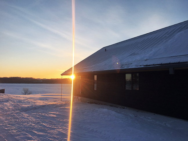

Winters are cold in Saskatchewan, much colder than they are in Germany. That's why the space heating requirement of the Passivhaus standard doesn't make sense in Canada.
In mid-November 2015, just before we moved into our new house, we were asked to be part of the Passive House Days tour (a worldwide weekend of awareness of Passive House and energy-efficient building). Well, not “officially” — we were asked to be a part of the tour by the event organizer in Saskatchewan, who was the Passive House (PH) consultant on what should become the first certified PH in Saskatchewan. Even though we did not build a PH, we did follow the standards as closely as I could justify. From the beginning we were not pursuing certification.
Although all of the visitors on the PH tour were very interested in our house, our process, and why we did the things we did, one question we got a lot was, “If you were following the Passive House standard, why not go all the way for certification?”
