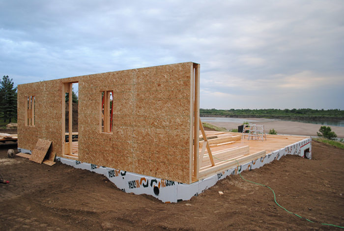

Exterior walls consist of two parallel 2x4 walls with an 8-inch space between them. Both 2x4 walls are framed 16 inches on center and have a double bottom plate to accommodate a 1 1/2-inch thick concrete floor. The inner wall is load-bearing. The south-facing wall includes three very large windows and a door that will lead to a patio. The windows let in winter sunlight for heat. All four exterior walls are now framed. Roof overhangs are 48 inches wide, allowing complete summer shading and optimum winter solar gain. The overhangs are far wider than the norm in the area.

Taylor and Curtis had of course never built this type of wall before, but they had done extensive research and were very motivated. This wall system includes two parallel 2×4 walls, spaced 16 inches apart, thereby creating an 8-inch void between each 2×4 wall. There is no need to offset the studs as the large void, which will be filled with dense-packed cellulose (recycled newspaper), has no thermal bridging whatsoever.
We elected to space the 2x4s at 16-inch centers for both the interior and exterior walls. It is possible to space the non-loading bearing wall at 24-inch centers, but when attaching the wood siding to the exterior wall (our non-load bearing wall), this might be a little more tricky.
Of course this wall system takes a bit longer to construct then your typical stick-framed house, as each wall needs to be built twice. What the guys did was to lay the lumber one on top of the other to ensure that the spacing was appropriate. The studs were nailed together with a double bottom plate (we will be pouring 1 1/2 inches of concrete for the main floor, so another bottom plate was needed in for securing the drywall) and a double top plate. The two walls were then secured to a 16-inch-wide 3/8-inch OSB header and footer, and tipped up into place using wall jacks. The walls were then glued and nailed into place and sheathed on the outside.
The first day they framed the west wall, which is 30 feet long. Honestly, the excitement of seeing a wall could not be contained that day.
On day two they framed the north side, which is a 48-foot wall with minimal penetrations — one window in a bedroom, one in the hall for ventilation, and the back door.
Day three was the west wall, again 30 feet long, which included three large windows. (Energy efficiency geeks will note that there is minimal benefit to large windows on the east side and there is risk of overheating in the spring and fall.) However, these windows look onto an amazing river view that we had to enjoy. The windows will have glazing with a special coating designed to reduce heat gain (more on that later).
On day four they ambitiously completed our southern wall, our primary 48-foot wall. This wall has three massive windows — each more then 10 feet wide — and a patio door to the deck. This side of the house looks onto a beautiful southern view across the river valley. The windows will also be a source of heat gain in the wintertime.
