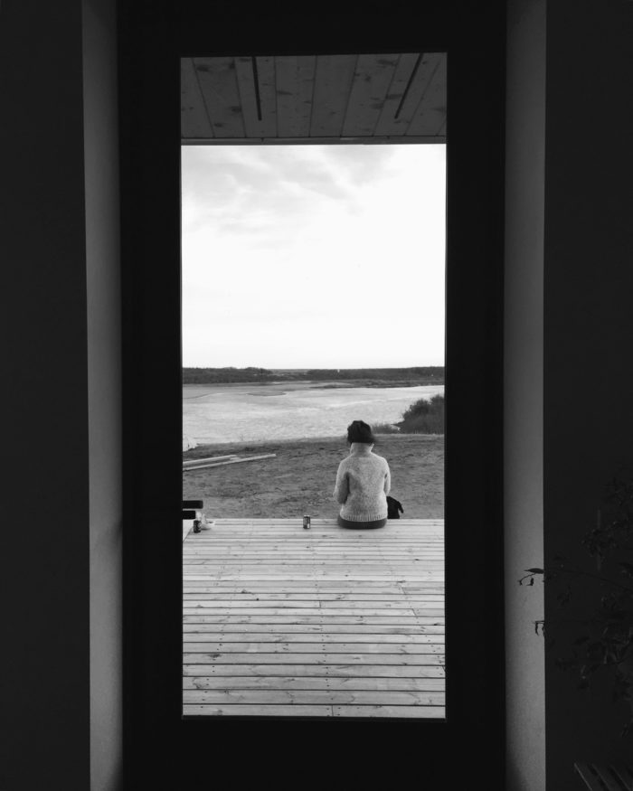

A view from the deck. Kent Earle took this photograph on a warm April evening, writing that he and his wife had enjoyed dinner and a glass of wine and looked up to see a bald eagle soaring over their heads. With construction virtually complete, the couple now gets down to the rural life they'd so looked forward to.
