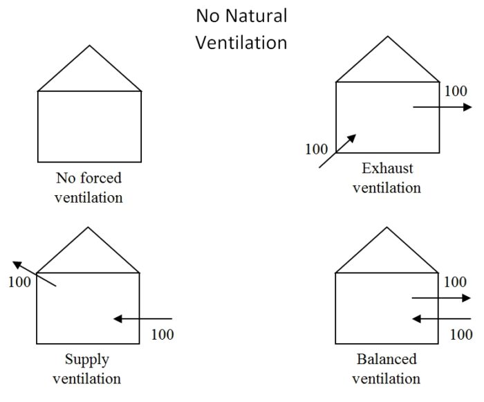

When the natural ventilation rate is very low
Suppose that we have determined that we need 100 cfm of air exchange in order to provide adequate ventilation. Let’s look at the performance of each type of forced ventilation system during a time in which the indoor and outdoor temperature are equal and the wind is not blowing. In other words, we will assume the natural ventilation forces are not present. Although the house has holes, under these conditions no air would flow into or out of those holes absent some forced ventilation system.
The fan of an exhaust ventilation system will blow 100 cfm of air from the inside to the outside. As a result, the average air pressure in the house will drop by enough that 100 cfm of air is drawn in through holes. (See Image #1, above.) Thus, it’s necessary to condition 100 cfm of air that would not need to be conditioned with no forced ventilation.
Similarly, a supply ventilation system will draw 100 cfm of air into the house, increasing the air pressure inside by enough to force 100 cfm of air to flow out through the holes. Like the exhaust system, there is 100 cfm of additional air to condition.
Finally, one fan of a balanced ventilation system will draw in 100 cfm while the other pushes out 100 cfm. Again, there is 100 cfm of additional air to condition (although it may be preconditioned by the core of an HRV). In this operating condition, the three systems each increase air exchange by the same amount.
