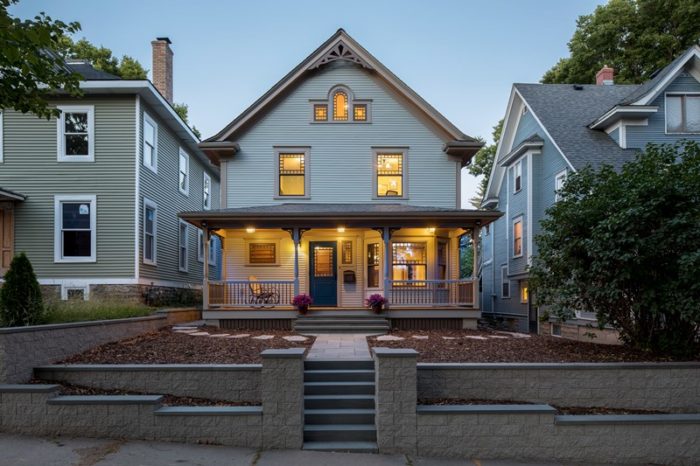

Image Credit: TK Exterior walls are insulated with 7 1/2 inches of expanded polystyrene insulation. Rafter bays are insulated with closed-cell polyurethane foam, sprayed in from the top. The new roof assembly includes a layer of sheathing below the I-joist rafters. CertainTeed says its AirRenew drywall will absorb formaldehyde in the air and convert it into an inert compound. A structural ridge supported at each end by a steel post holds up the new roof. Above the OSB sheathing are I-joists rafters insulated with closed-cell spray foam. Rafter bays below the sheathing are insulated with fiberglass batts. One challenge was finding craftspeople skilled enough to tackle the Victorian details inside the house.
In 2014, I learned about net-zero energy at the Minneapolis Home & Garden Show. Shortly thereafter, my wife and I purchased our retirement home and interviewed five sets of architects to compose the core of the design team. We settled on Marc Sloot of SALA Architects and Sean Morrissey of Morrissey Builders in St. Paul, both with considerable experience in sustainable design and construction. The result is our net-zero Victorian, showing that a standard city house on a standard city lot in chilly Minneapolis can be renovated to be net-zero in energy with no sacrifice in attractiveness, space, or comfort.
The design and permitting took more than a year, beginning in August 2014 through the end of 2015. We sought a variance in local zoning since the exterior walls on one side of the house were already over the side-yard setback from the property line, and then added 1 foot of exterior insulation, which moved the exterior wall surface even closer to the property line.

We have the satisfaction of knowing that we have rescued, renewed, restored, and repurposed a perfectly viable Victorian treasure in a way that preserves its character and demonstrates that a neighborhood can be revitalized without being reduced to a brownfield.
The house has achieved — and surpassed — net zero. The energy-conserving measures described here have kept the electricity consumption to 12,000 kWh for the first year — far less than the 17,000 kWh we generated from solar panels during the same time frame. Our house is therefore “net positive,” producing more energy than it uses.
This extra energy is sold to our local utility, Xcel Energy, at an effective rate of approximately 20 cents per kW hour. In our first year, the system produced about $3,000 worth of electricity, yielding a return of about 7% on the initial investment of $40,000 (after the federal tax credit).
