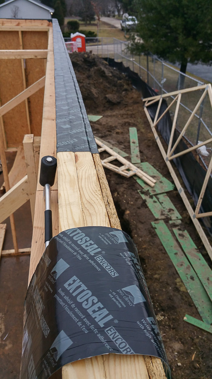

Once the wall assembly details were figured out, and our ceiling setup detailed, the transition between the two became the next challenge. In other words, how to carry the air barrier over the top of our exterior walls.
I found an article by Chris Corson published by The Journal of Light Construction to be very helpful.
Using a waterproof peel-and-stick membrane to wrap over the top of the wall (going from exterior sheathing — in our case 7/16-inch Zip sheathing — to the interior side of the top plates) seemed like the easiest way to maintain a continuous air barrier at the wall-to-roof junction. The membrane would also have a nice air sealing gasket effect after the trusses were set in place.

Finding the right flashing tape
I tried using rolls of conventional peel-and-stick window flashing membrane, purchased from Home Depot and Mendards, but it performed poorly, even in unseasonably warm temperatures for February in Chicago.
I switched to Grace Ice & Water Shield, normally used as a roofing underlayment along the first few feet of roof edge. Because it came on a long roll about 4 feet wide, my wife and I cut it down to a series of strips that could more easily be applied to the wall-top plate connection. While the sun was out, the Grace membrane worked fairly well, especially when I applied pressure with a J-roller.
Unfortunately, the sun and warmer temperatures didn’t stick around long enough for me to finish. Within hours, it was back to rainy, gray, and cold — typical Chicago winter weather for February. When the weather went gray and cold again, we started to use a heat gun to warm up the Grace membrane, which had turned stiff and nearly useless in the cold.
After wasting a lot of time and effort trying to preheat the Grace membrane before installing it, I finally relented and switched to the much more expensive (but also much more effective) Extoseal Encors tape from Pro Clima. Where the Grace membrane lost virtually all of its stickiness, the Extoseal Encors stuck easily and consistently, with the J-roller just helping it to lay flatter and more securely.
It was a case of trying to be penny wise but ending up pound foolish. Looking back, I would gladly pay an extra $300 in materials to have those hours of frustration back (including the time it took to run to the store and buy the heat gun, which turned out to be ineffective anyway).

Because of the cold, the Grace membrane was beginning to lift at the edges in certain spots, so just to make sure it had a nice long-term seal, I went around the perimeter of the house and used a layer of Tescon Vana (3 inches wide) tape to seal the edge of the Grace membrane.
